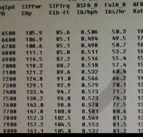

This is a 16 in non ethanol mode. In the bsfc's. You can see were it's a little lean from 6500-7100 just like I said. Add fuel here .

and where it take away fuel -1 7500-7750, -3 7750-8000 I can see it is rich in that table and why you did that. But Maybe I should just change those to 0 also? Seems to be where I am starting to DET
JUST REMEMBER THAT IS ONLY THE 100% COLUMN, YOU NEED TO CONSIDER 60-80% TOO FOR THE PEOPLE THAT GET DET AT THROTTLE ANGLES LESS THEN 100%.
