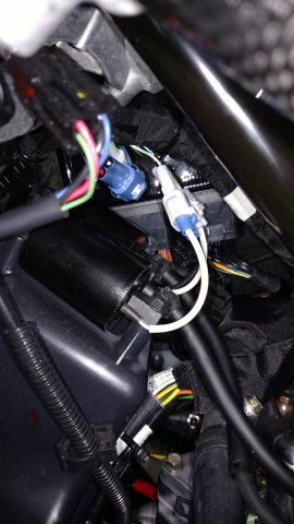

Would someone who has thiers working check some wire colors on coil connections for me?
My white/green goes to white wire on pto coil
the white/blue goes to white wire on mag coil
on the harness plugs the green and blue wire go to red wire on blue plug, dummy to white
the black wires go to black wire on white plug, dummy to white

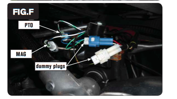

you have it wired correctly as long as you're referring to the PTO coil that's actually mounted on the mag side of airbox,not trying to insult your intelligence just making sure bud
Wire coming from mag side of cdi is actually the PTO wire needs plugged into green strip
wire from pto side of the cdi is actually the mag wire needs plugged into blue strip
the plug with green/blue and dummy plugs into red/white harness wire
the other one (black w/ yellow stripe?) with dummy plugs into other harness wire that has white wire on same side as dummy

I see where everyone might be making the mistake on coil hookups. When they say the dummy plug to the white wire. That means the empty side up plug needs to be on white wire.
Make sure the side with wire is not connected to the white wire.
I did the exact same thing with the dummy plugs!! I guess they are appropriately named. I had them backwards. After switching so the white wire is in the blank side of the plug WA LA IT LIVES
