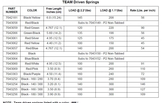

I just came back to re read these post and noticed your 70-90 spring rate for the secondary???If you have an S or an X model the a shorty or switch.

0 to 2000' ft above.
Shorty or switch with a ripsaw or cobra, studs or no studs. 1.74 gear ratio, primary- 120 to 130 lbs rate spring, 70 gram weights(68 if your 275 lbs+)
Secondary, 66/44.46 or 50/44full , 70 to 90 lbs rate spring.
Shorty or switch with 1.5" + lug track. 1.81 or 1=86 gear ratio. Primary and secondary the same as above.
As you see I just named the spring rate, that's because lower/ higher engagement and spring finish lbs can be changed for studs,no studs,1.25" lug or 1.5"+ lug.
If you choose not to re gear, then none of what I said above will work for you .
That's the rate of spring Dave not the load.I just came back to re read these post and noticed your 70-90 spring rate for the secondary???
Hmm. I guess I have only looked at spring rate for primary springs. It's not commonly mentioned for secondary springs. I am not denying it's there though.That's the rate of spring Dave not the load.
The reason I mention rate is because I don't wanna give someone a wrong spring choice that might not work for them.That's the rate of spring Dave not the load.
It's a good place to start Dave then finess it from there.I understand that Brock. But there is a caveat with all the different clutch setups. What works for one may not work for all. Too many variables. Best thing to say is, This is what worked for me, it may not work for you.
