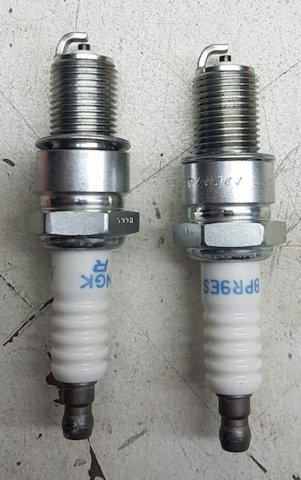

Check your plugs. They are supposed to be .027 gap
all the ones i have checked are around .024
It may make a difference. Bigger spark

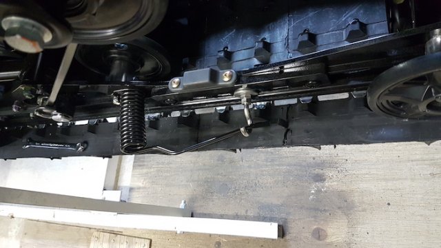

Install Good scratchers without removing wheels for normal scratchers and those dont work with clearance issues.
Dont even start about cable scratchers. Those are junk and don't last. Wish i had a pic of my friends cables before he threw them out. They stoped touching the ground after a while and caused overheating.
Doo Summit scratcher kit, Extra Stainless hardware. some washers and extra nuts and locknuts

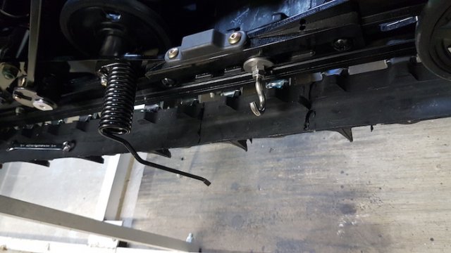

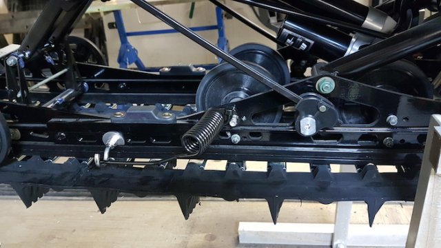

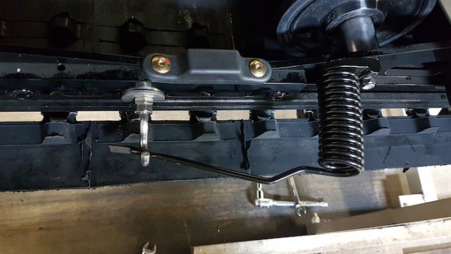

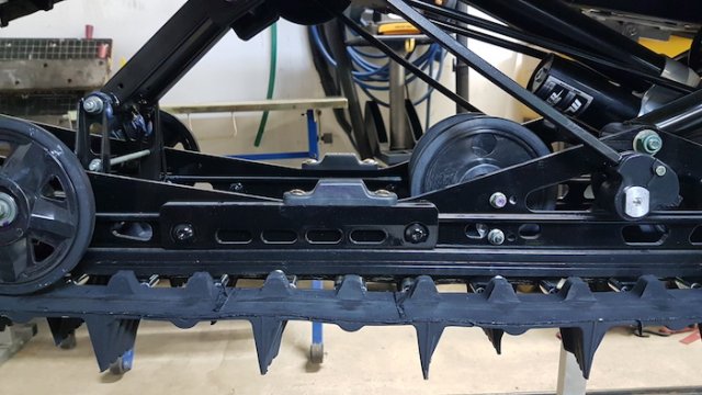

Each side theres 2 holes close together the wheel can be installed. use the rear hole on both sides

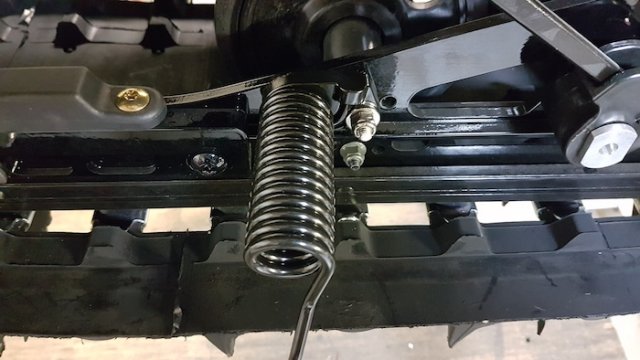

Remove rear middle wheel bolt. Use 3.25" bolts install the right bracket for the side your working on. I never took a pic without the sctracher on. On the bracket theres 2 holes. use the forward one for the wheel bolt.
With bracket bolted on drill the rear hole in bracket.
then u can install the scratcher. Use a washer on the new wheel bolt to hold the scratcher on. you can see on the pic

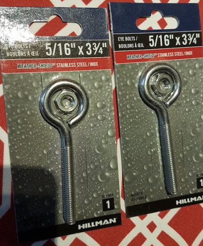

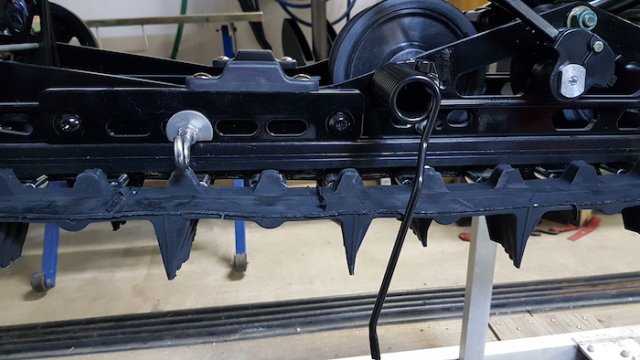

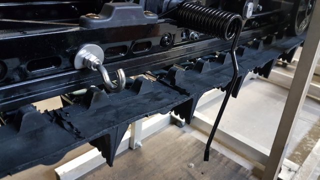

The hook is important. Cut just under half of the eye out. no less
drill the hole for eye hook in this distance..
The length of it sticking out is important.
Has to be out far enough so If you bottom out the top wheel comes down and the gap you cut out of hook allows the wheel the extra 1/2" of space. The wheel can go into the hook if u know what i mean.
you need a straight edge on top wheel and that will show you where the wheel will come down exactly. Adjust your hook as necessary.
Use 2 nuts if u can. will help support the hook sticking out. The washer i cut some off so it clears the sliders.

after you get the hook stud adjusted where you wanted it. On backside allow for washer and locknut. Mark and cut off excess stud
Just double check the hook doesnt touch the track after

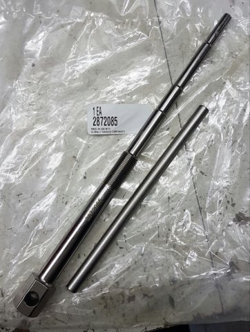

Heres the tool you need for clutch removal

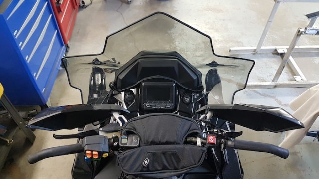

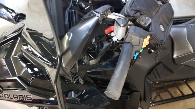

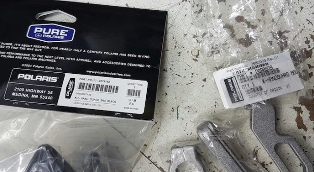

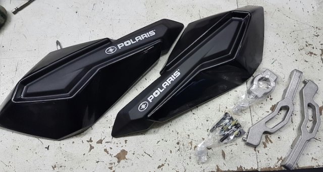

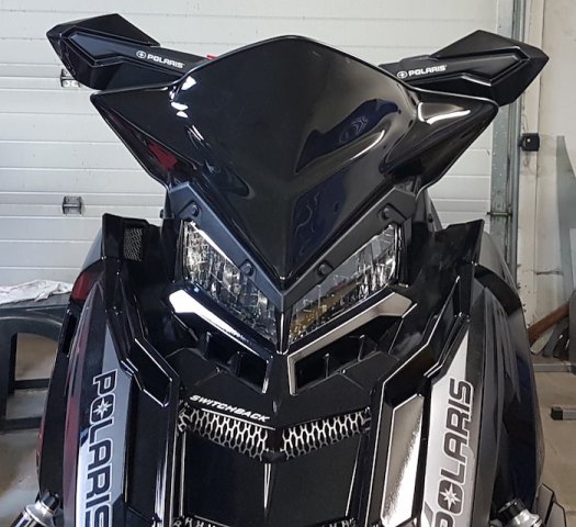

I usually get the Rox Flex tec handguards. Best but most expensive. The polaris ones seem pretty good and the mounts are heavy duty and nice. They fit nice.

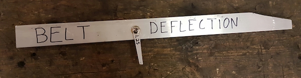

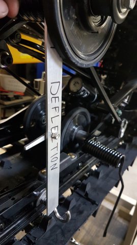

Here the belt deflection tool i made. Stick it in there and flip the lever down

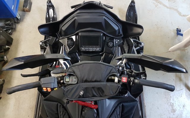

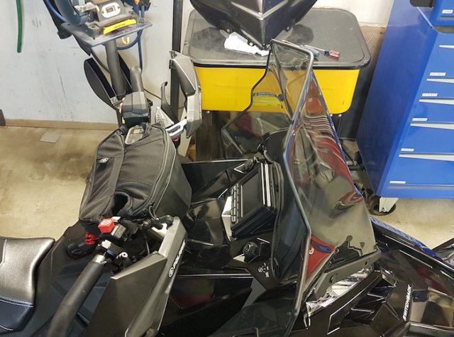

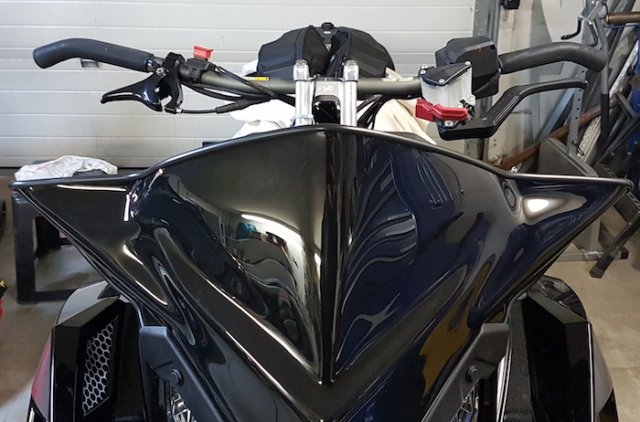

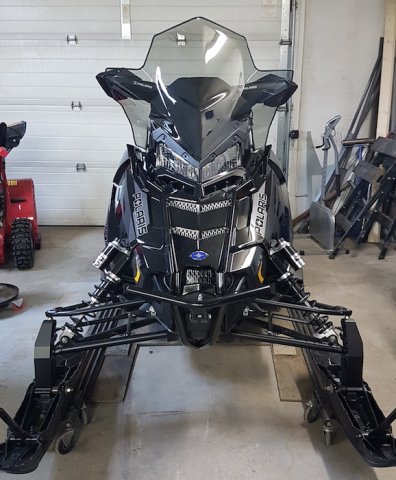

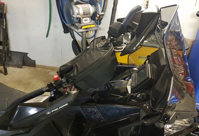

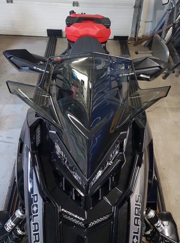

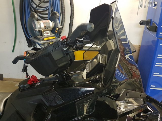

I checked my handguards with my tall windshield today. They will work. They just touch if your turn steering full lock which you would rarely do anyways. Sweet. 90% of the time with mid windshield. If its going to be cold then 4min swap large windshield on.
Heres pics with the large dash bag on. Left the bag of when had large windshield on last time for testing.
