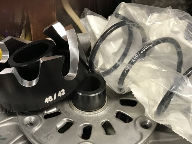

Any one run this secondary on their 600 and tune it beyond the oem 2013-2014 setup?

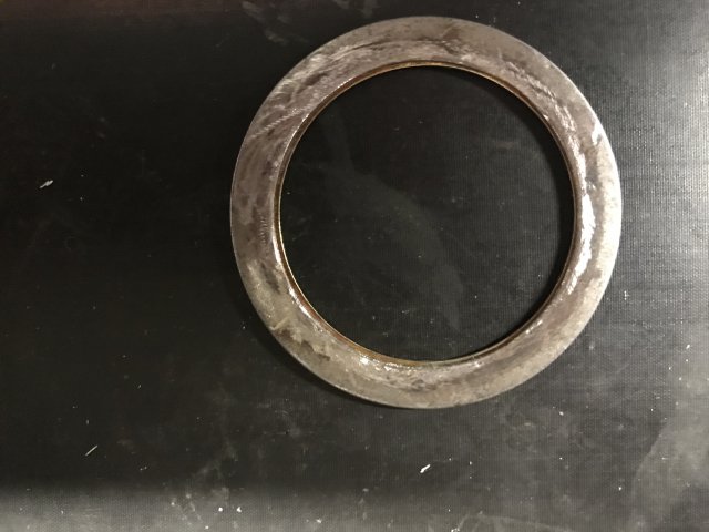

Dalton helix and Polaris P2 spring for the 600. Helix backer shim ground out some to help the snap ring fit better on the clutch post. It is evenly opened up, just not a square picture.
The best answer I have is sort of a question. On his first ride last year my son asked me, "What did you do to the 600, it is stronger?" With that being said along with the P2 setup, I also added a BMP pipe mod, drilled the air box shelf, and added VF3R reeds.

Gabes, did you ever run into the snap ring not seating well like I mentioned my fix for above? I heard it was not unusual years ago,

I have a P2 in my 2020 Indy XC 850. I've never had an issue with the snap ring coming off of the slot. They work way better than any Team. Too bad that you can't get any parts for them anymore.:mad:
I found a lot of post several years ago that were several years old then, about the snap ring popping off. I seen for myself on both P2’s I bought how they didn’t seat well till I opened up the ID on the washer
