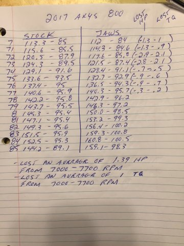

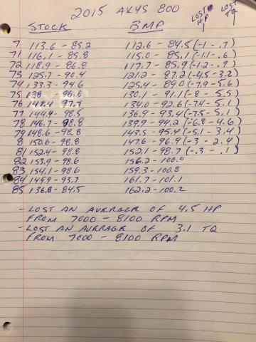

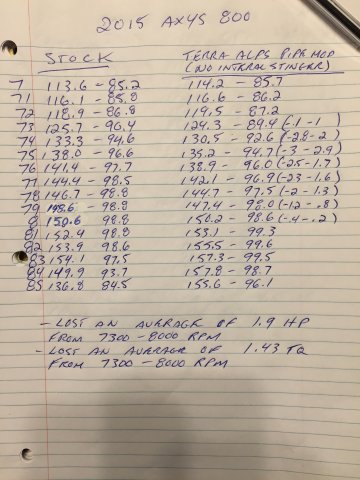

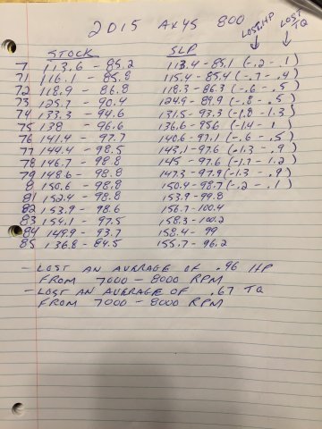

The stock pipe from factory pipe is very well made from low end corner to corner (7-8000 rpm). It's hard for the pipe makers to beat the hp and torque from 7-8000 rpm. To me this is important. This is not a bash against any pipe maker. It's just the plain truth. I jotted down some comparisons from stock pipe to pipe makers and you'll see the hp and torque lost in different areas .
Have a look and chose wisely
Thanks for all the testing and posting of results you do Brock. I decided to run the Jaws single for these reasons.
#1 No fuel controller required
#2 Seemed like the best balance between good peak hp, and not too much lost in the mid.
#3 Held good power of 160ish for extended long runs without any sign of deto
#4 they are a Canadian company. No disrespect to any of our southern brothers..but I just prefer to not have to deal with the hassles of cross border shopping.
You can see the slp and jaws don't give up to much power to factory pipe(pun intended) lol
Some times it's not about the big end number. It's about not giving up power and making a wide power band .
This is what's important to me!
Hope you guys can understand my writing skills, lol
So, don't make fun of your buddy with the slp pipe because it doesn't have huge big end numbers
Thanks for sharing very interesting. SLP and Jaws look like a very good choice for real world riding. Bragging rights drag racing the top end pipes are way to go I think and I believe 5 hp or so lost in mid range you can't really feel the seat in pants difference.

Do you still think there was more to be had in the mid-range on with the Jaws pipe that was due to testing on the 2017 (break in mode) rather than the 15? It is hard to determine that since it's not apples to apples across the board. I suspect that the Jaws pipe on the 2015 should be similar as most other after market pipes as compares to the Fact pipe. (and without tuning)

This really makes it clear how all the SLP guys swear the thing runs awesome on snow with the SLP pipe and runs with other pipes that dyno more hp.

What is the story with the Straightline Performance pipe? Rumor is there original version also had the internal stinger design and that is how they got insane HP on the dyno. But the Final production version they removed the stinger all together which is why they make 0 HP?
