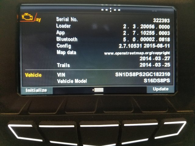

Does anyone have problems updating the maps. I get a warning that mine are out of date. I download the update and it uploads ok. Date on screen will not change and still get the warning message. Does this to both of my sleds, different dates.

Whats the release date referenced in the txt file in the map update folder (zip)?

Should be newer than that. Try the failed update feature on page 76 in the PIDD manual.
