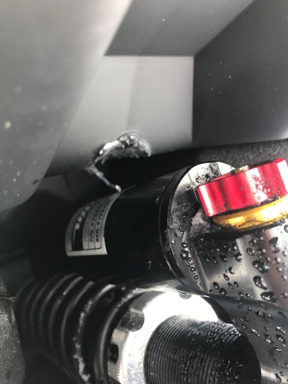

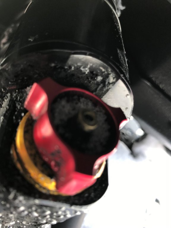

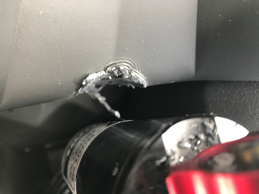

If you are using the lock and ride rear bag/rack combo on a "Rush" with Walker Hi-Lo shocks take a peak under there and make sure this hasn't happened. As you can see the low speed adjuster is MIA as a result of rubbing on the bottom of the bag. Sucks! I will have to switch to the smaller bag as I see no solution to avoid this happening again without changing to the standard shock or hacking up the bag.

Same thing happened to mine I took mine off now just carry my candy in my pockets.
Update. Just got back from dropping my shock off at the dealer. The rear lock and ride bag has been updated to accommodate the WE hi-lo shocks. The one I have was from 2015 and the new one has a flat tunnel to work with the shock.
Apparently Polaris was already aware of this and I was sold new old stock last year seeing as Polaris chose not to change the P/N's. Shout out to John Hartwig Polaris! Exchanged the bag no questions asked.
