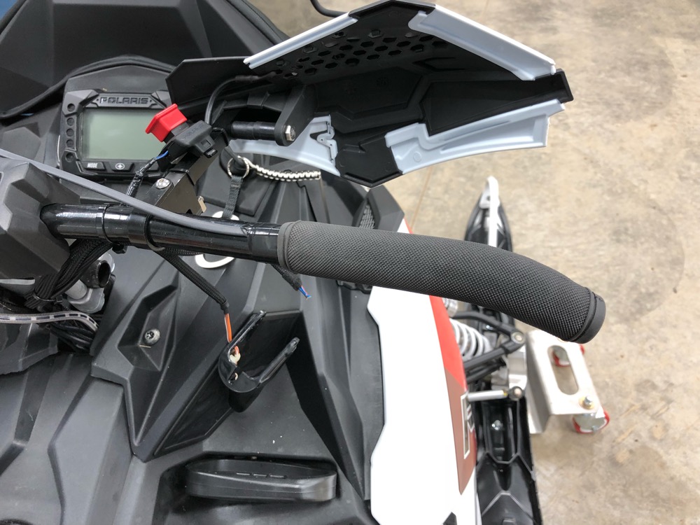

I’ve been less than impressed with the heat that’s coming from the hand warmers on my 2017 Switchbsck 800. I have them on high all day and still have cold hands.
I think I have a solution.
After a bit of research on here and hard core sledder I’ve come to find the solution is to put and insulting barrier between the hand warmer element and the bars.

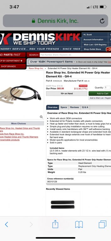

I purchased a set of RSI high power heaters with plug already wired for Polaris sleds from Dennis Kirk
PN 5900025 (see pic)

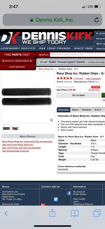

I also got a set of RSI grips
PN 595916 (see pic)

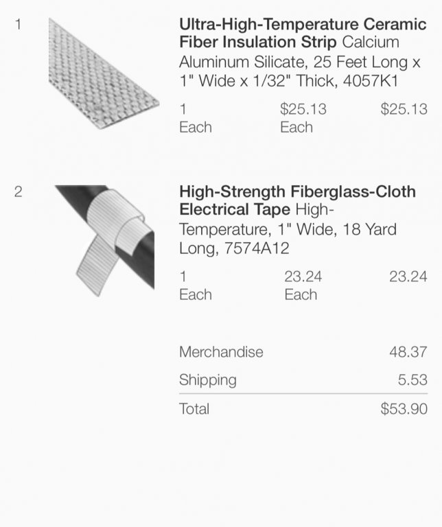

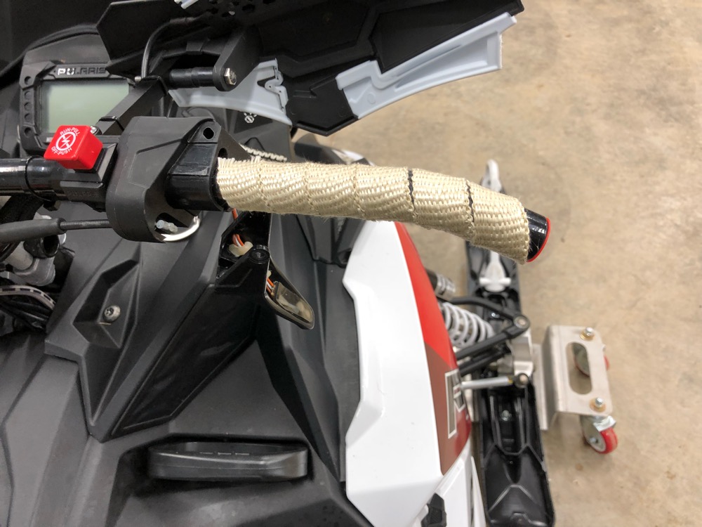

Most people are using cork as the insulator. I don’t really like the idea of something so crumbly under the grip. I found some insulating cloth tape and some insulating fiberglass tape on Mc Master Carr
PN 4057k1
PN 7574a12
(See pics)

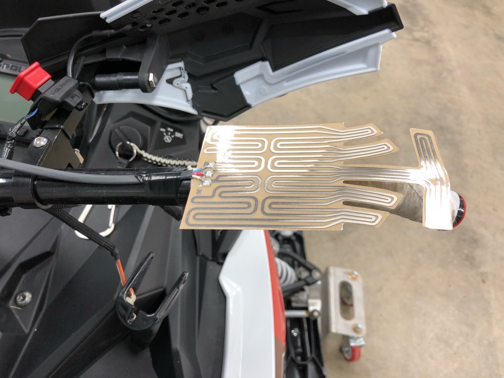

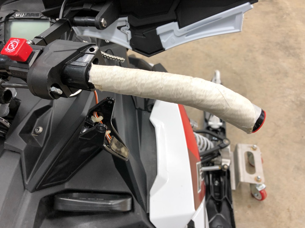

I removed the old grips and warmers. Wrapped the bar with the cloth tape then wrapped the cloth with the thin fiberglass for a little more insulation and to give the new heating elements something to stick to.
I put on the elements and pushed on the grips using the compressed air method. Wiring was plug and play

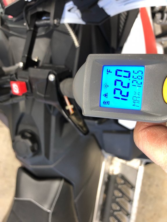

In less than 2 minutes at idle in my shop the grips were at 122 degrees and climbing (see pic).
I’m looking forward to trail testing next weekend.
The job was pretty easy especially if you take your time.
I’ll let you know how the real world results turn out.

Went out yesterday with the new setup and the results were great. Outside air temps never got above 0 degrees F. Rarely did I have to put the warmers on high. Used low and off most of the day. What an improvement!
