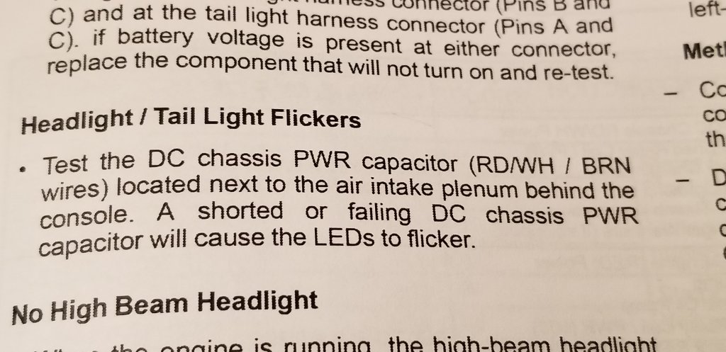

Anybody have the headlights blink constantly on your sled? 2016 Pro - S 800. I'm thinking voltage regulator. Haven't started to check connections or anything like that. Thanks.
Update: Found out the problem was a bad capacitor. Was told there are 5 of them on a 16 Pro-S 800. Just an FYI
