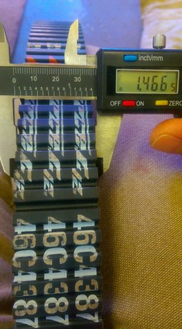

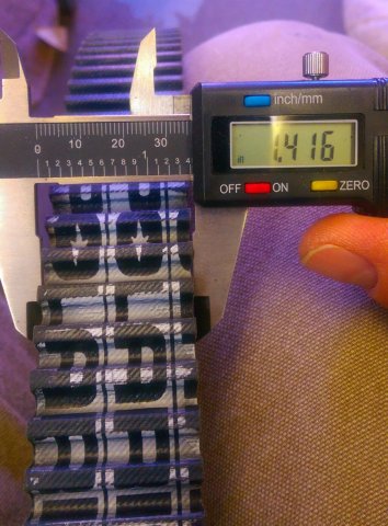

View attachment 387 View attachment 388
The measurements don't lie.
0.050" wider is huge brand new. I'd say 3+ mph on top for guessamation from my findings over the years.
Will the gate's belt last and take the punishment though?? A few guy's have some miles on these and could chime in .:)
We can't get these in Ontario yet so I bought one from my good friend drnotadoo late in the season and didn't get to test yet. $75.00 us is about $90.00 Canadian. If it works and performs well, I'm going to be a gates buyer.
I do know the Polaris belts for these axys models are inconsistent and I'm not liking them so far on the performance side. If you have a brand new poo belt, I suggest you ride alone for 20 to 30 miles and break it in very easy,(no hard wot pulls). They are way to expensive and need to be broken in lightly.
I'm glad we have some choices:)
Looks like Polaris may be sitting on a lot of belts. :rolleyes:
Lot of variance. Measurement's can be subjective though. One guy may put a little more/less pressure on the thumbwheel of the caliper, different calipers also. Kind of like guys all using different compression gauges and having different numbers. My used one only measure .004 less that the one Brock posted above. I am guessing his was new. My new one is .006 wider than his above.
