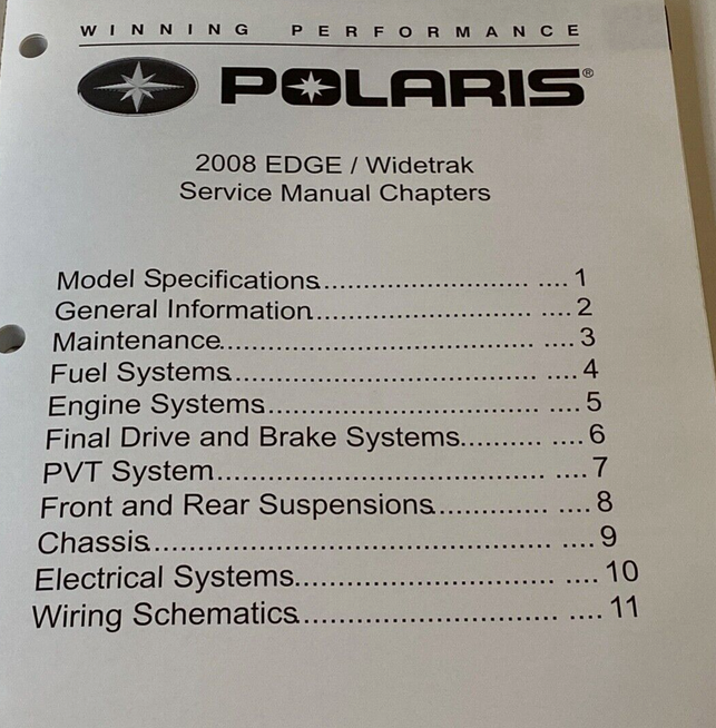

But why is it so difficult to find a wiring diagram (electrical schematic) for this sled - and others?
I have a '01 335 Sportsman, a '02 400 Sportsman, a '15 Ranger 400 & a '15 Indian 1800 Vintage (technically a Polaris??).
Every one came with a wiring diagram in the Polaris Service manual PLUS they are easy to find online.
What's with the sleds??
Anyone have a link to a 2008 550 Trail Touring would be greatly appreciated.
Thats odd...Did someone rip them out of the copy you have? I found one on ebay and it shows theres wiring schematics in the service manual index
Thanks. Certainly possible that it was removed although I can see no damage to the book.
I also found one that will do the job.
Appreciate your help.
