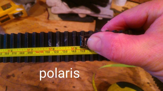

A new Polaris belt for 800 axys is around 0.040”-0.060” belt to sheave normally. Check with new belt?

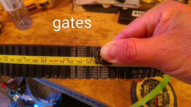

Gates belt is around 0.020”-0.030” wider then the Polaris belt

Whatever belt you end up using, don't forget to check the belt to sheave clearance. .010" to .020" is ideal for a new belt. Once you verify the clearance, that will be a benchmark to determine belt wear. Once the clearance opens up significantly it's time for a new belt.
I know this sounds basic, but be sure to set belt deflection also. When properly set, these two adjustments will give you a killer holeshot.
